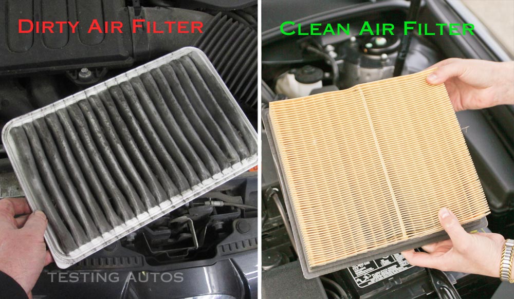

The air filter is inspected during your regular oil changes. Your mechanic can check its condition and let you know if it needs to be replaced. Many mechanics test the condition of the air filter by looking at the light source through the filter. If no light is visible through the filter, it must be replaced.
For example, compare these two air filters in the photo below. The filter on the right was changed one year ago, but the owner of this Honda drives over 24,000 miles a year. Now it looks dirty, so the owner decided to replace it again.

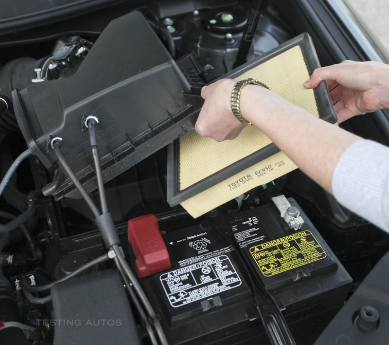

If you want to check it yourself, your vehicle's owner's manual has the engine compartment map. In some cars, to open an air filter box you will need some tools, like an 8-mm or 10-mm socket or a screwdriver. In other cars, the air filter box cover is held by a few clips. In most cars, it's not a very difficult job. Whenever an air filter is replaced, it's a good idea to clean any debris that may have accumulated inside the air filter box.
If you change your air filter yourself, make sure it fits properly and the air box is closed tight after the job is done. If the air filter box is not closed properly, the Check Engine light may come on.
