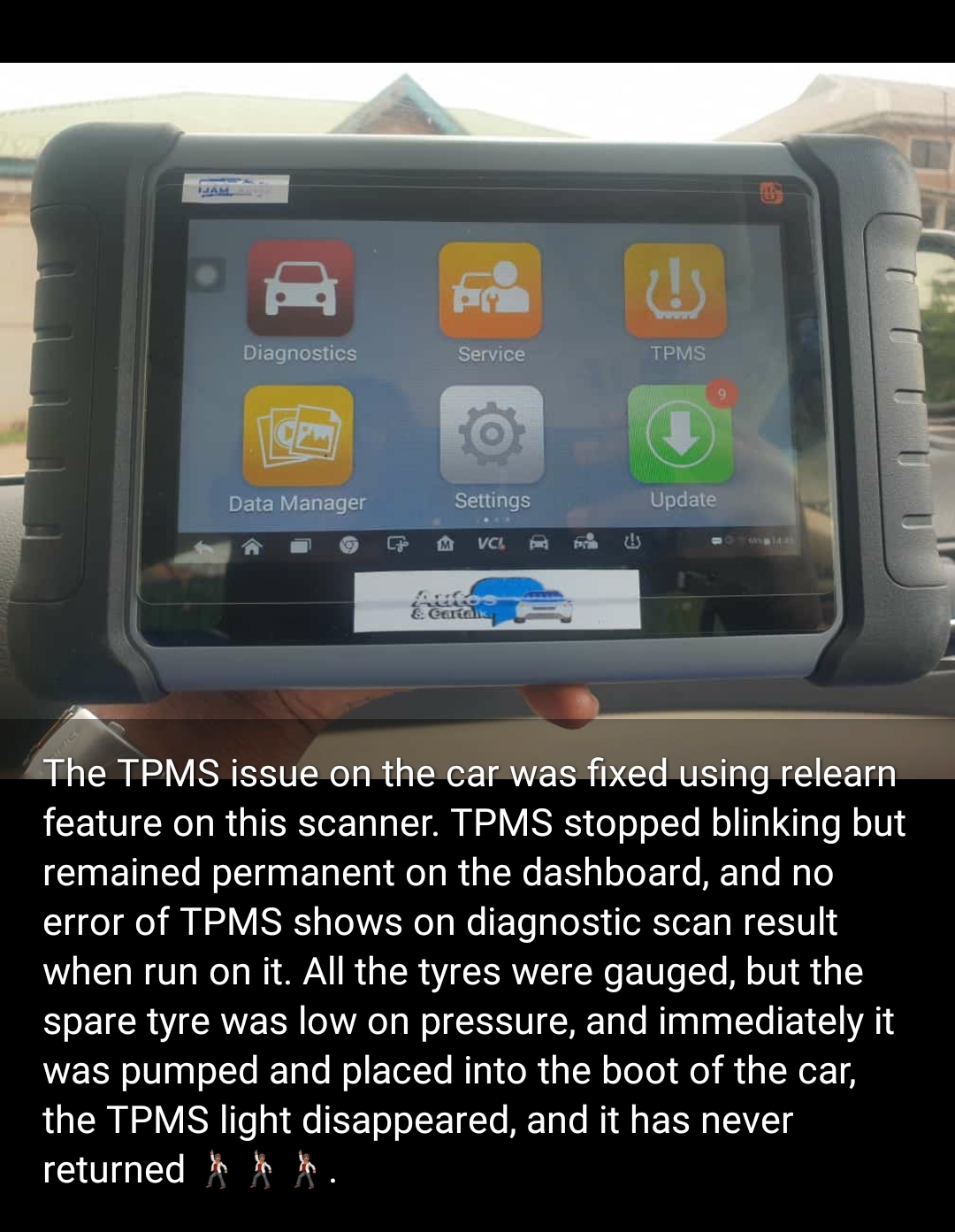

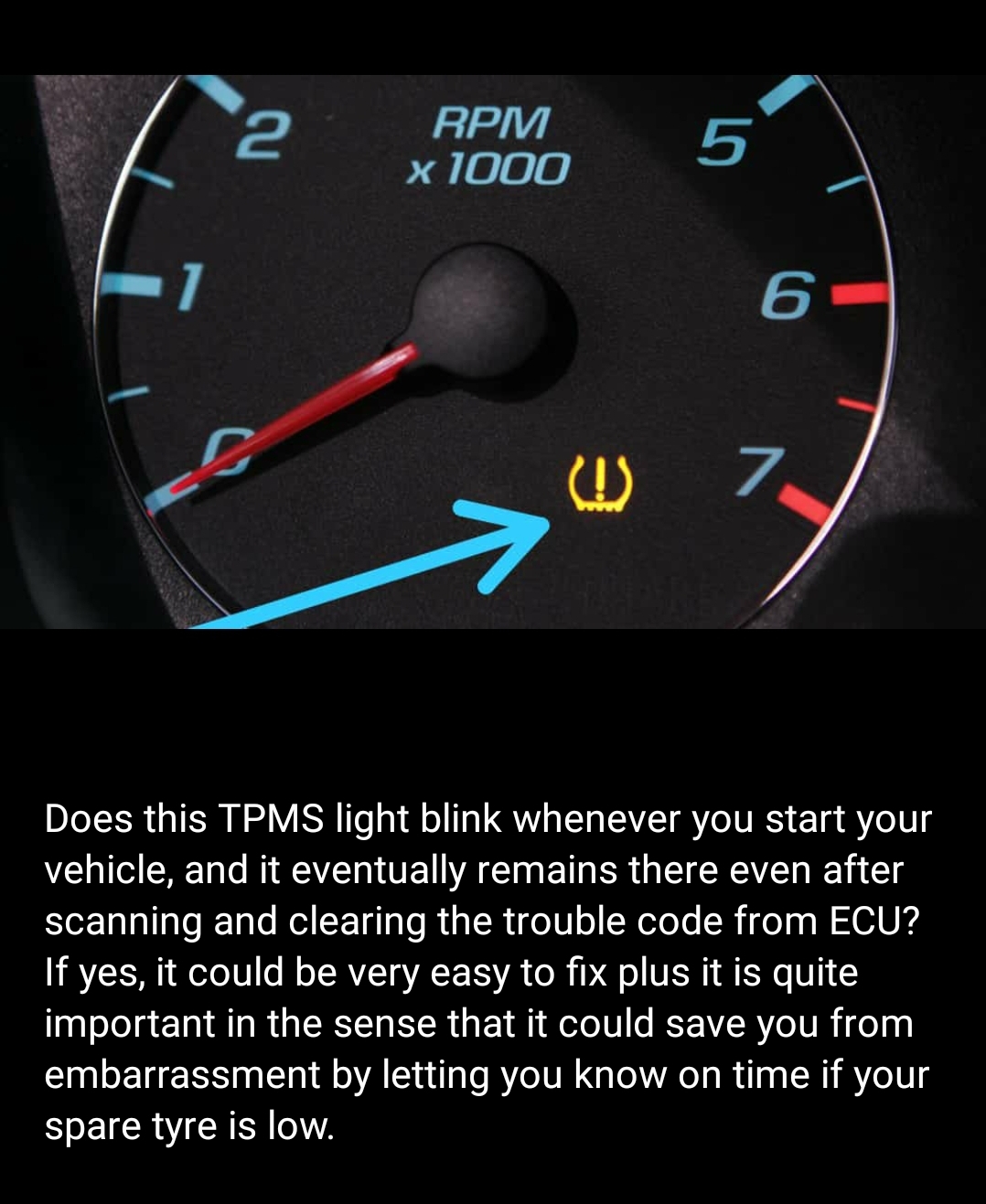

What could cause the TPMS light to be on the dashboard except if any of the tyres of your vehicle is low are:
1. If you change tyres/wheels
2. If any of the TPMS sensors are bad or its battery is bad Solution ranges from replacing the battery if possible, but the best is replacing the sensor, programming or relearning them.
Troubleshooting will point to the option to follow but most often, relearning the tpms sensors using powerful scanning tool solves most of the issues causing the TPMS light to be showing on the dashboard of most vehicles.
